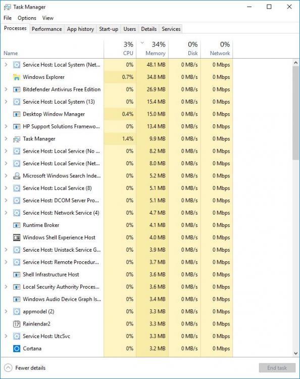

Boris Posted November 16, 2016 Report Share Posted November 16, 2016 This PC runs Win 10 Home 64bit quite happily with 4gb installed - only 1.5GB actually used as I write this. Your 3.4GB seems a tad excessive, but it depends what the various running processes are and what they are doing. Quote Link to comment Share on other sites More sharing options...

Boris Posted November 17, 2016 Report Share Posted November 17, 2016 This is mine when just "idling" Main processes using memory :- Quote Link to comment Share on other sites More sharing options...
