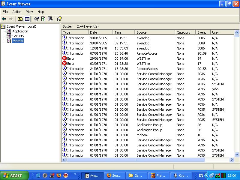

doug Posted July 23, 2005 Author Report Share Posted July 23, 2005 Just done a re-start and got the same problem. So switched off and re-booted and told it to boot to normal windows - OK. Here's a screenshot. As you can see there's some funny dates there. Quote Link to comment Share on other sites More sharing options...
rong Posted July 23, 2005 Report Share Posted July 23, 2005 Have you checked the date or year on the clock. Quote Link to comment Share on other sites More sharing options...
doug Posted July 23, 2005 Author Report Share Posted July 23, 2005 Yes, that's why I changed the battery. Measuring the old battery gave 3.05 volts so I don't think that could have been the battery. The screen shot was after I had checked the date before and after the re-start. Quote Link to comment Share on other sites More sharing options...

rong Posted July 24, 2005 Report Share Posted July 24, 2005 So can you explain the dates? Quote Link to comment Share on other sites More sharing options...
